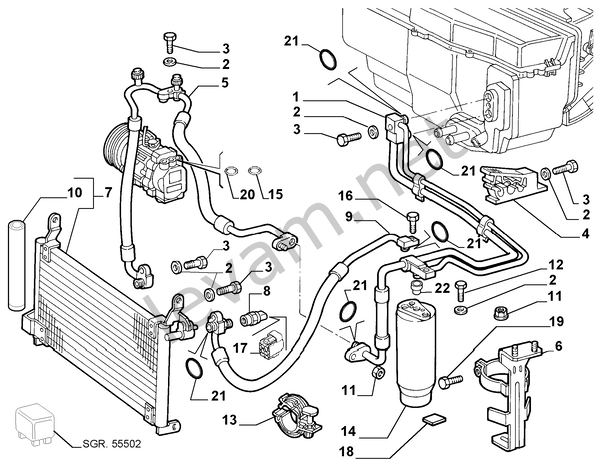

Aussi appelé :
Fiat Multipla Stilo Sensore Climatizzatore
PRESSOSTAT SENSOR  (N8 sur schéma)
  46476438
FIAT 46476438 for FIAT MULTIPLA MULTIPLA (1998 - 2010)
VENTILATION AND HEATING
PRESSURESTAT [-] (#8)
Ref  60655085 [A 4 LIVELLI] SUR 4 NIVEAUX de positions
https://fiat.7zap.com/en/mul/1f/28673300-099/501/1+50101s02+2-0/#8
++++ la pièce en visu
THERMOTEC KTT130009 Pressostat, climatisation
https://www.auto-doc.fr/thermotec/3349392?gshp=1&gclid=Cj0KCQiAzeSdBhC4ARIsACj36uGLnsCIeWgxVQ-SXRhTmcGBcThRQorEUrEx9sWC3ExxY7v5Bd-zS_MaAnR0EALw_wcB
