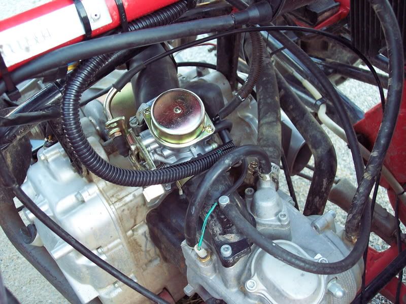

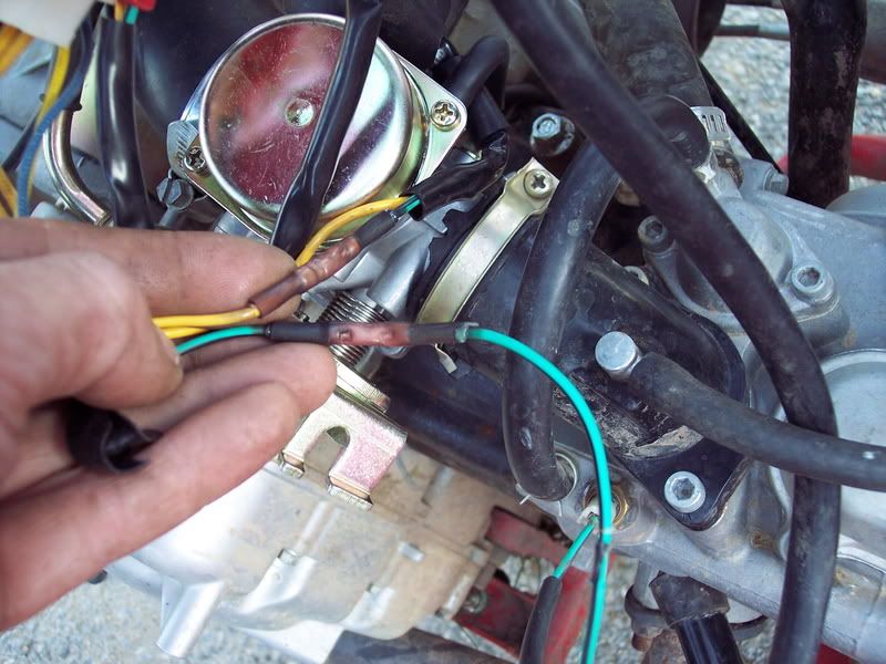

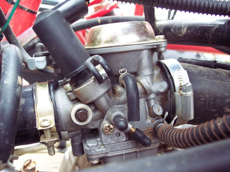

the 260 comes with, 30mm , not much adjustment,
I removed and installed , the 32mm, with some wireing as the "bystarter valve" is 2 wires and the stock carb is 3 wire
